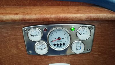

    • Here is a shot of the dash with all the instruments installed. The LEDs are units I picked up at the local parts store. The green one ties in with the main power switch. The red one will be adapted to light when the control box buzzer goes off. I'll have to add in a pluggable harness for that to work correctly. Unfortunately, the voltmeter is messed up. It constantly reads 16 volts even though there is 12 at the terminals. I've got a replacement on the way.

        What brand gauges are you using?
        What's your plan for the control box buzzer harness? Do you have a diagram drawn out already? Just curious...
        • They are Suzuki gauges. Nice and easy to match up to the engine and they look correct with the Suzuki tach.
          As for the buzzer, I already have the wiring diagram that came with the control box. I'll probably just make a copy of that and then draw in the plug. It should be a simple affair of just adding a 1 into 2 Y harness. I'll see if I can find one, if not, I'll just solder one up. Probably do the same treatment for the ignition interrupt for the charging relay. I haven't wired that up yet, partially because I need more 10 gauge wire to get the connections mated up. Mostly, though, I need to insure that the ignition interrupt is in place to preserve the ACR unit.

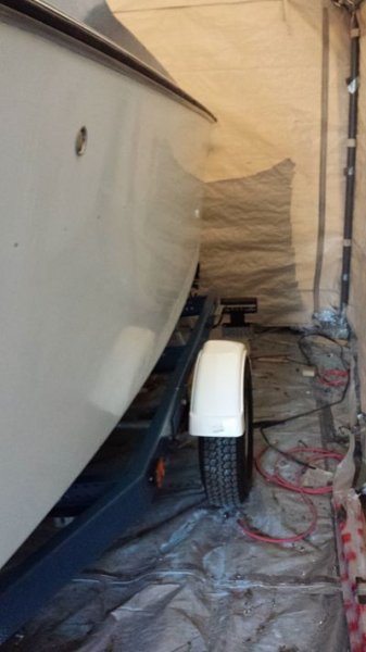

                        While she was in the boat house (and the reason I left her there) I moved the axle back on the trailer and fit new fenders. She pulled much better yesterday when I hauled her out, with less bouncing on the ball. Also, with the new fenders in place, there isn't a clearance issue with the boat any more. That was a real problem since I brought it home years ago.

                            I snapped this shot this morning. REALLY cold out! 17 degrees is just too cold. Anyway, as you can see, there is now zero issue with clearance of the fenders. Before, they were literally about 1.5 inches from the chines on both sides when the boat was centered. Not the best situation. They still need some work though. Due to the way the axle is mounted, I had to mount the fenders towards the center. As a result, they tend to wobble a lot when going down the road. I'll probably get a couple pieces of galvanized flat bar and brace them on the inside.
