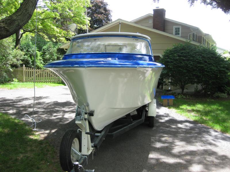

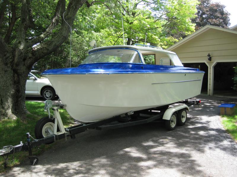

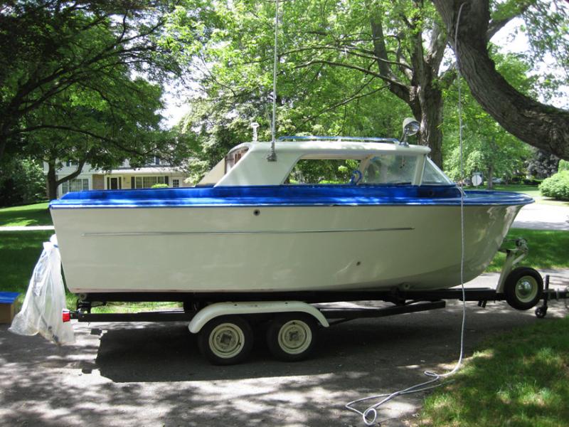

    Hi All:

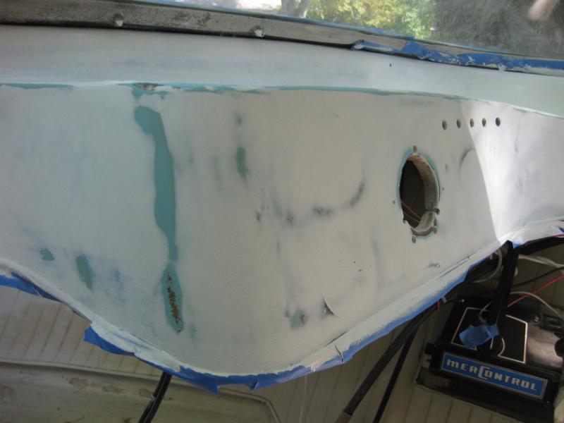

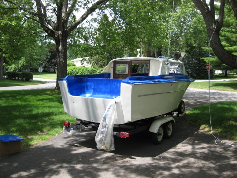

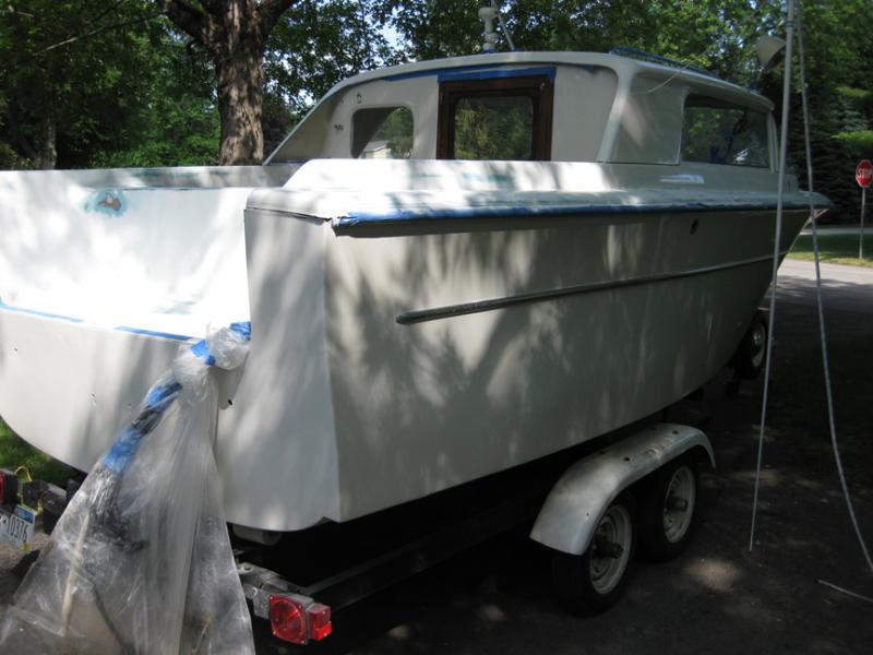

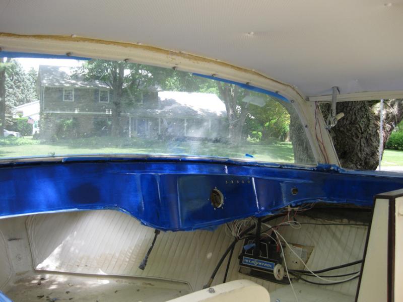

    It has been a while since I have contributed so I thought I would share my on going saga with BellBoyJohn's BB 404 Sedan. The first paint job we applied was in '05. I only sanded and applied one coat of Pettit Easypoxy. The job and result were mediocre in my estimation. After gaining some experience with Interlux Perfection last summer on my 404, I wanted to repaint john's boat with the same paint. It took hours and dismantling and sanding but now I am seeing the light at the end of the tunnel. I primed the entire boat with 404 epoxy primer the painted the hull and roof with two coats pf Perfection Oyster white. The deck, dash and splash-well are painted in Royal blue. As the pictures show, the blue is quite vivid - stunning really. The blue will need three coats, I imagine. Have any of you found that applying the darker colors of Perfection require more coats? The paint is just fantastic. I include shots of my BB in the garage on John's trailer. The paint looks as fresh a year later as the day I applied it. I am sold!
    Now that looks nice
    I think with most paints in the dark colors over light paint or primer, it takes at least a couple of coats.
    That paint is pretty cool isn't it :BigWink1:

        Yes, I am prepared for three coats of the Interlux Royal blue. I am using a radom orbital sander with 320 grit between the blue coats but I don't want to sand through anything! Whats underneath is so much lighter, I would have to do so many coats if I sand through. Would you all recommend sanding with a block by hand at this stage? Thanks for any advice,

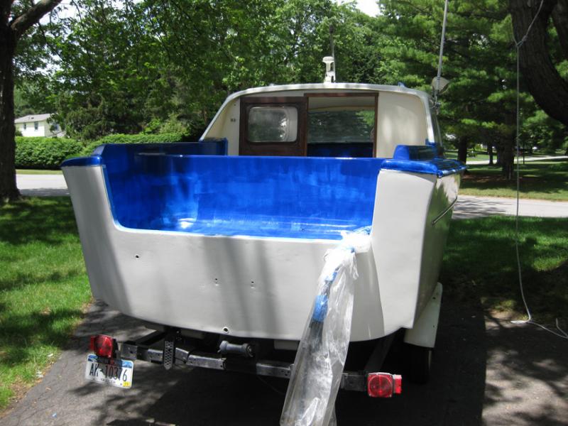

              troublecome application of the blue

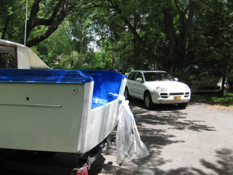

              Well... The royal blue is not cooperating for some reason. I have put two coats down on the splashwell area and the result was better coverage - although the blue areas WILL require a third coat - but the paint is not flowing into a smooth flat surface like the Oyster white did. Could it be that I am painting mostly horizontal surfaces on a warm sunny day and the paint is curing too fast before it flows out properly? The result is a very stippled surface from the foam rollers. I never had this issue with the white. last year. I had great success with the Perfection by only rolling it on with no tipping. I DO remember reducing the white with their thinner ( 223) a bit. Maybe the blue, which was applied without reducing is in need of a little flash retarding reducer to lay down? What do you all think??

                Reduce it for sure Bob. I like the Interlux paint. I also use it on the Kayaks I build. Like you, I get different results with every project. The weather conditions seem to have a big effect on the results. The key is getting it thinned down properly. Plus I prefer to lay it down in cooler temps. Below 75 degrees if possible.

                    Bob, having lived just up the road from where you are, okay 150 mi. Sackets Harbor , I can imagine the temp and high humidity are playing a big part in the outcome of the finish. A retarder as suggested and working in the evening will help but I think the stippling,tiny little bubbles from the foam roller, will require that you DO tip with a good quality brush as the paint is flashing too quickly. Just my $.02.
