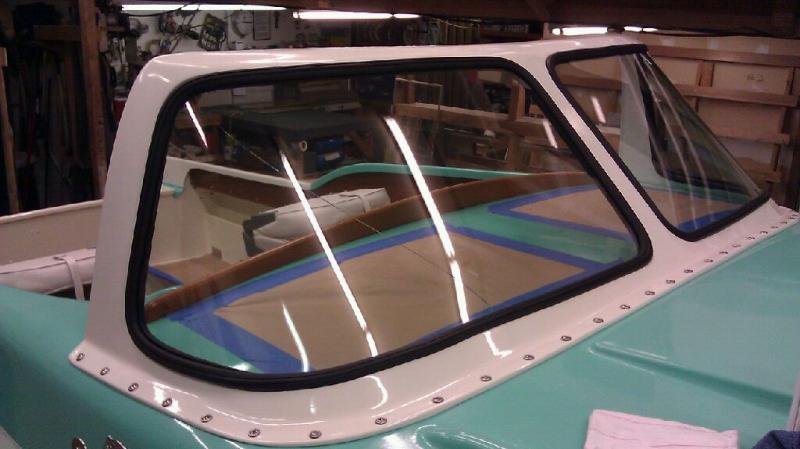

              Here's a shot of the installed windshield, taken by Jim at Associated Glass. The photo shows the crack that unfortunately developed in the starboard-side glass, but otherwise the two pieces fit in the frame after they cut the glass straight down the middle, then ground a radius into the inside corners...following the pattern of the Skagit fiberglass windshield frame.
              Charlie and Pat are wrestling with what to do about the cracked-glass situation right now...waiting to hear what it'll cost to start over, whether to switch to plexiglass, or whatever.
              I'll update the situation as soon as we know the outcome, and especially after I've seen the installation in person.
