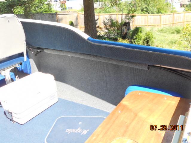

            Like Steve said, I do use Lowe's / Home Depot ( At Lowe's they are starting to drop some of the colors so i kept a extra rug for the floor in Bainbridge ) indoor/outdoor carpeting in most of my boats. I also use 3M Super 90 Spray glue that i have never had a problem holding the rug on the side walls. Lowe's does guarantee's it for 3 years , however i have seen it last up to 9 years. I only had to glue it down on the floor only on one boat. If the rug gets wet i just slip a few wood blocks under it to dry. The reason for that is i lay the rug down first and then screw down the Pedestals so it will not move around. You can still roll it up to the back of the Pedestals and when the time come to replace it, i trim it around the base of the Pedestals for my next pattern, but don't seem to keep a boat that long to have to do that.

                    The carpet is the quickest and is super cheap at $3 foot or so if at Lowe`s.The sprayglue needs to be sprayed on both surfaces,then let tack briefly and glue agian as it goes together.Pressure makes it stick,so push hard everywhere and do it again later in day.
                    You can also staple where you know it will want to lift,namely around edges of motor box.
                    I`d cut it short at rear corners and use some half-round trim to secure edge.
                    I found some carpet at Lowe`s that looked like it had Salt,pepper and beauty bark all mixed in.....was perfect for hiding muddy footprints.
