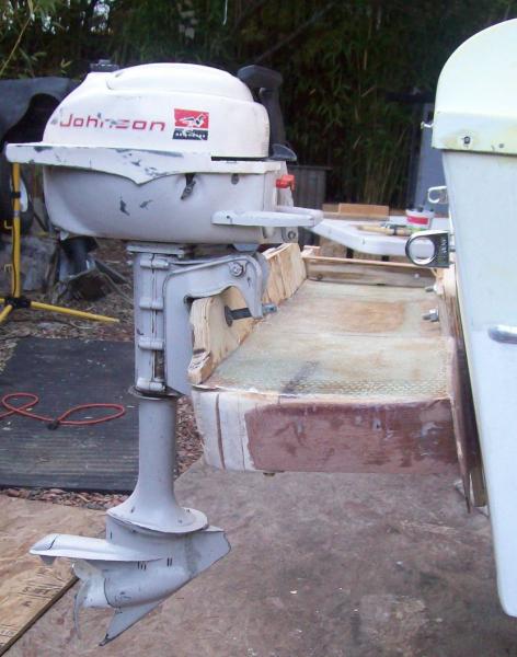

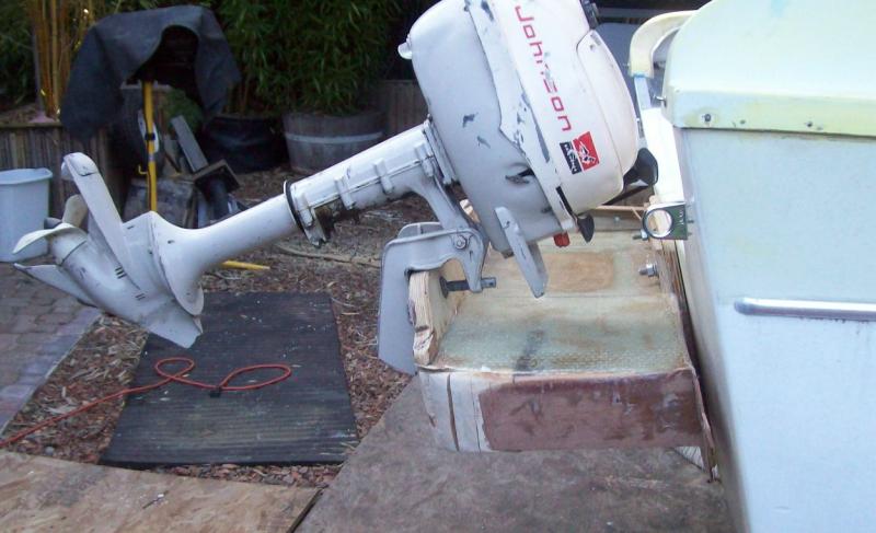

    Tail Heavy?
    Mark,
    I`m really worried about wt.balance with the similar Bellboy hull my buddy owns....
    I made sure to add flotation to keep it hopefully level with the new Swimstep /Motor bracket I`m almost done with.Not sure I added enough....
    Seeing yours already at a nice angle (but before the 2nd motor is hung) leads me to suggest maybe a test float with a full trash can or two filled with enough water to simulate the actual load.
    You can even overload it to see what a 4 person crew and fuel would cause.
    With water you can siphon it out or bail with 5 gallon buckets to quickly empty the weight,then do another test run to get a good baseline for seeing the difference between the two.
    Or get some bodies and tell everybody no dancing.
    Save that for the happy owner!
