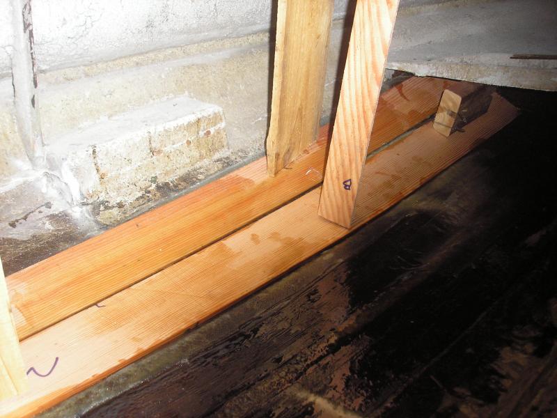

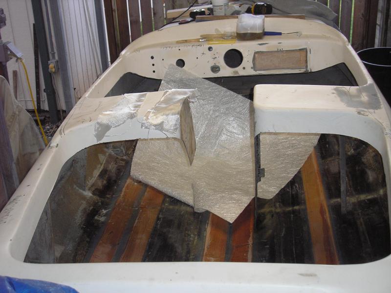

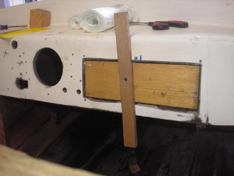

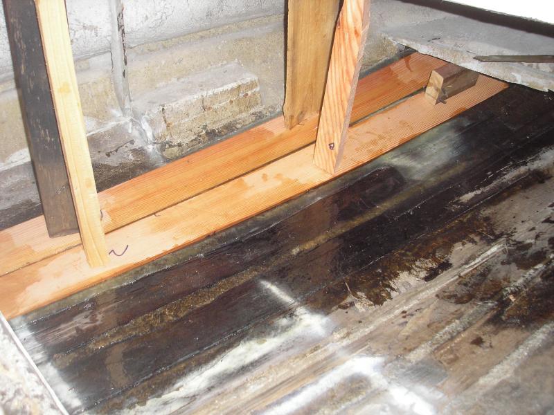

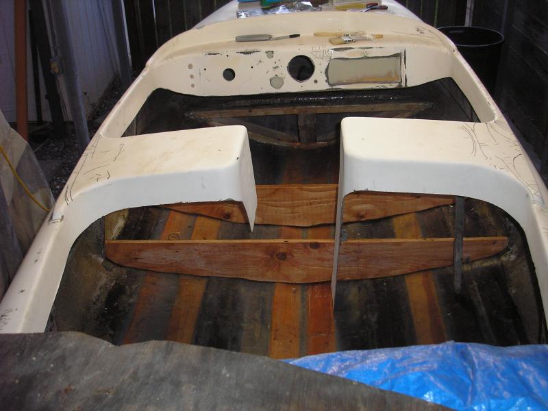

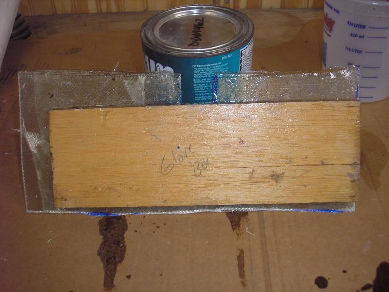

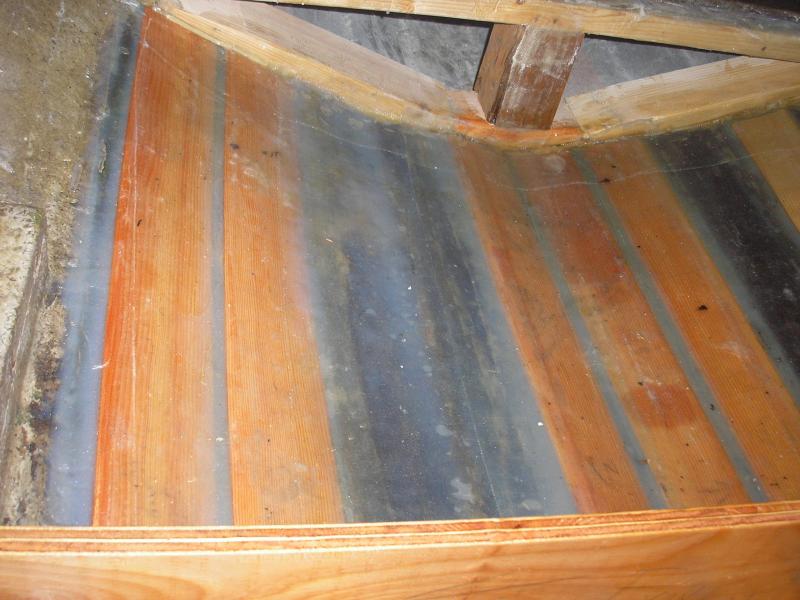

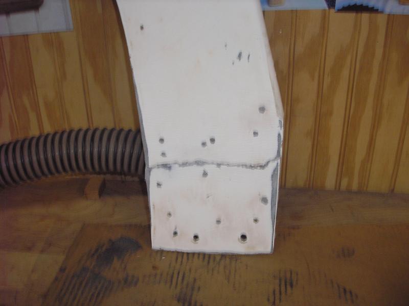

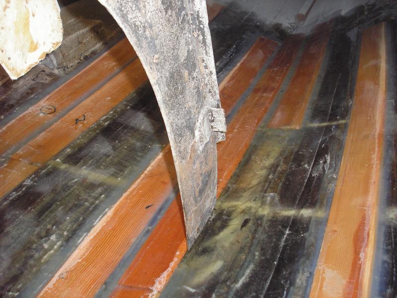

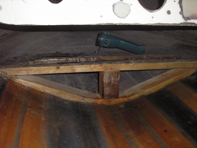

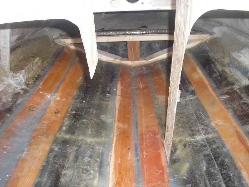

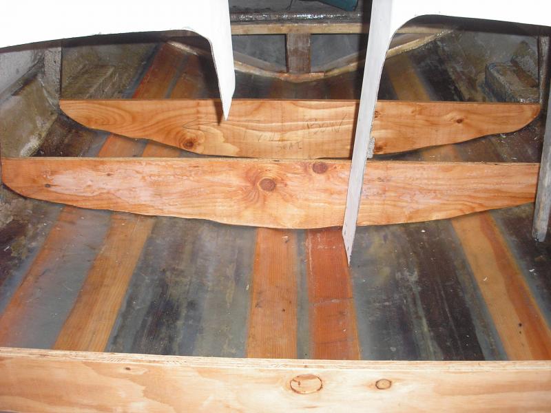

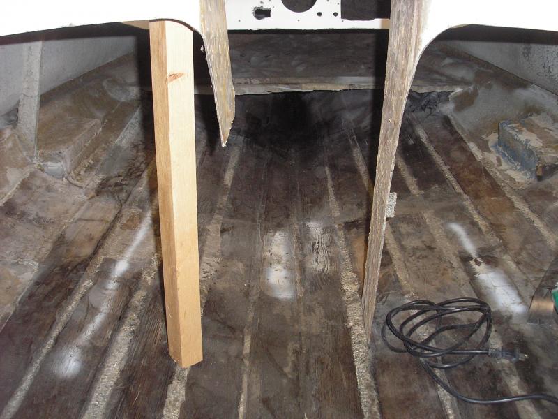

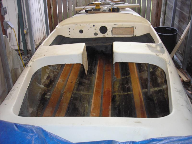

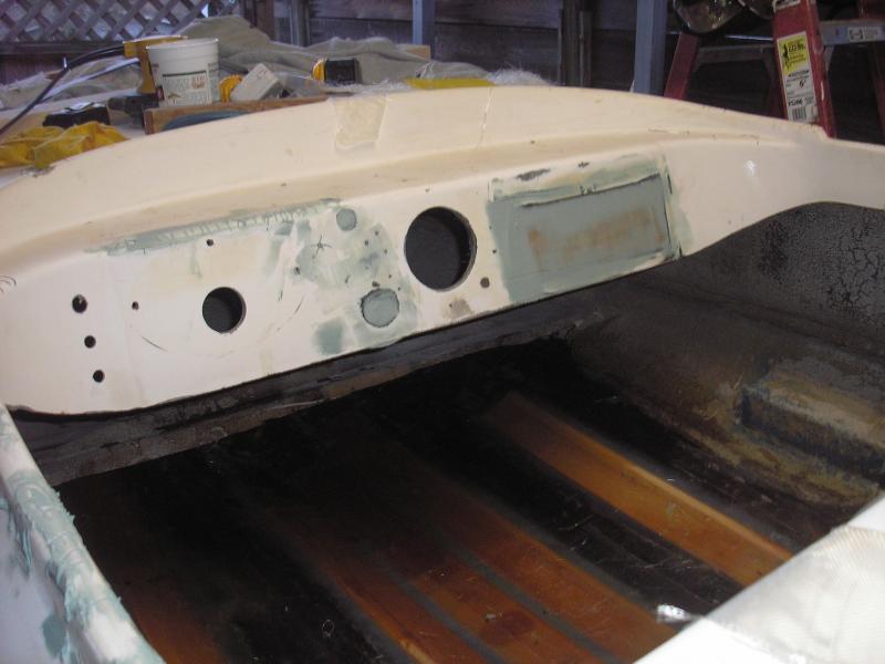

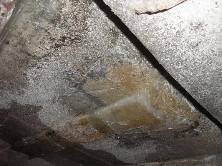

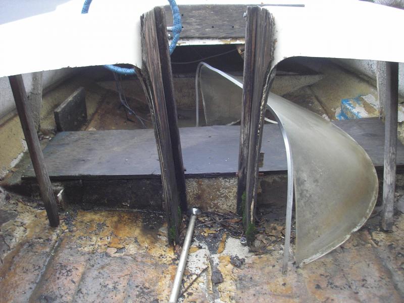

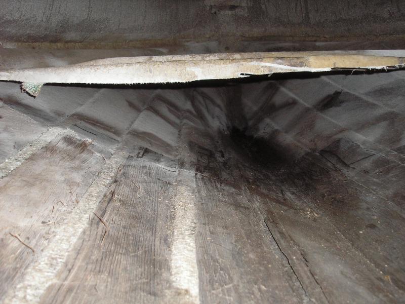

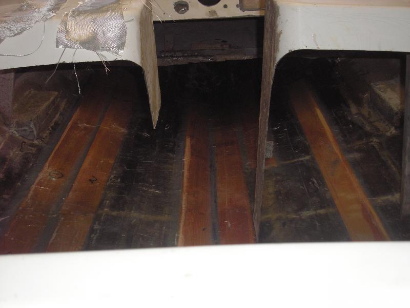

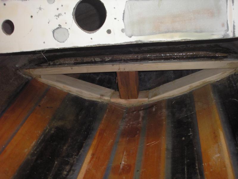

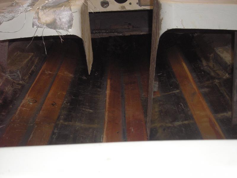

Got two of the new stringers glassed in from the bottom and made a patch for the glove box hole. I'm going to move the steering from the port side to the starboard and going to fill all the holes except the Speedometer hole and start over. When I get the stringers in place I will sand them down so they blend in then put a layer of glass over the whole bottom. That Piece that holds the seat up that was broken in 3 places I had to patch and when the bottom is finished I will connect the entire piece back in place. Nice to have a little warm weather since I'm working outside.
