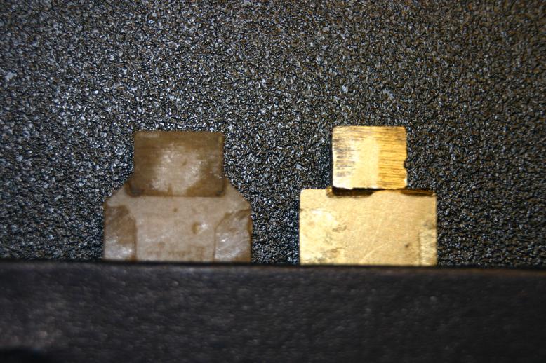

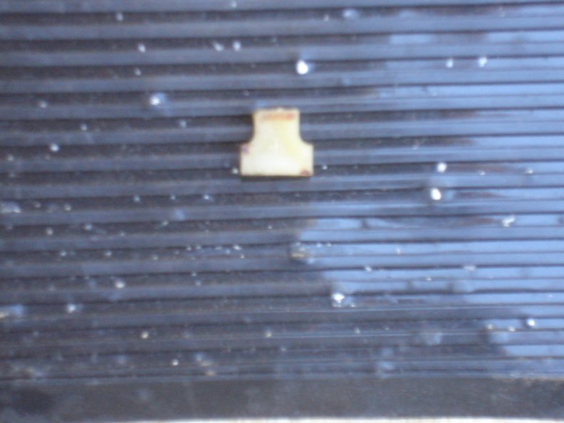

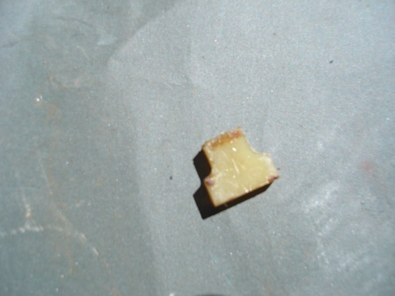

Had to pull the Homelite in June.
Have to replace the cam with the new revised cam with the nylon distributor drive key. Mine had the old style drive key. Hence have to change out cam with new style drive.
Got to check out valve clearances and put the proper spacers in.
Hope to have it up and running before it is time to put the pontoon away for the winter.
