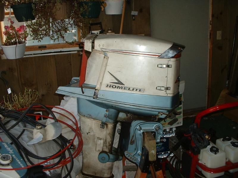

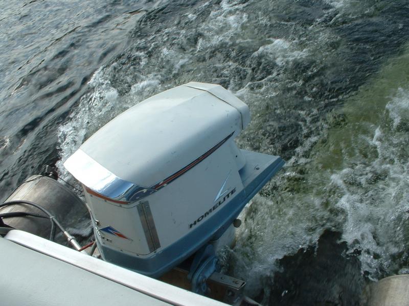

I hope you have better luck this time around! Interesting front access on the hood, easy to get to the carbs for adjustment. I just got done stripping my cracked block of all it's salvageable items. Now I've got an exhaust valve for the #3 engine.Dick Johnson

Yea,
That's they way I got it. The past owner did a nice job on that access door.
My Homelite isn't totally original. But close.
When reasembling the motor I noticed the spring clips on the distributor were sprung a little and didn't hold the cap down tight. I repositioned them and now they are tight,holding the cap down firmly. I checked the inside of the distrbutor today after several hours of operation. No irregular wear on the contacts in the cap. Looks good. No little brass shavings either.
