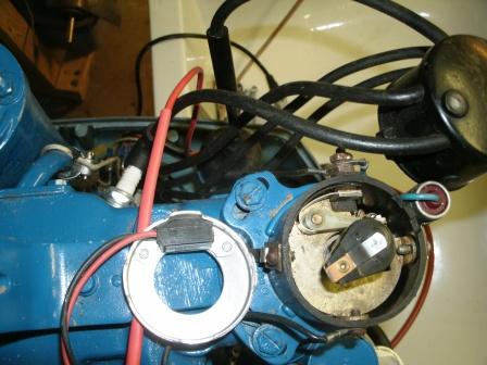

So the Pertonix was delivered! My first question for the collective wisdom of the group is the orientation. Is the orientation I have noted in the picture correct, or should it be rotated 180 degrees ? The instructions are not clear on this point.
Thanks! MattAttached Files
Just looked at my F block and it's 180 from your picture. The one from Tim's engine was installed as your picture but I changed it to be like the F block so the wiring came out of the distributor on the coil side. So I don't think it makes any difference since it's creating a spark four times at one revolution of the distributor and it's the rotor that is directing the spark to the proper spark plug.Dick Johnson

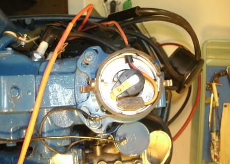

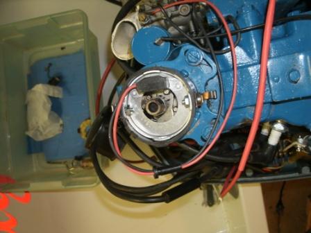

I took Dick's advice and installed the pertronix breaker plate so it was easiest to run the wires out of the distributer as shown in the first pictures. I then shorted the grommet so it was easier to run. Next was installing the sleeve over the distributer shaft. The fit is very tight and I had to use a significant force to get the sleeve down to the level of the electronic unit.

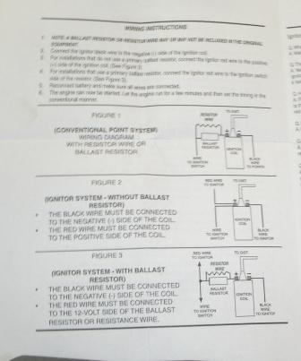

Finally, I wired the black wire to the negative side of the coil and the red to the positive side of the coil. I have not tried to start it up. I thought I would again seek the collective expertise of the group to double check my work and make sure I have not made any blunders. I appreciate all input!
Thanks Matt
Matt, I had to take some material off the bottom side of the rotor as the distributor cap would not sit down tight on the distributor. Something interesting I find in the directions you posted is about the ballast resistor or resistor wire, the red wire from the pertronix should be on the 12V side. The factory wire to the coil is a resistor wire and most likely is only 9V. If I'm interpreting this correctly the red wire should hookup to the 12V side of the terminal block. However both of mine are hooked up as you have wired yours and it seems to work fine. I'll have to do a little investigating into this.Dick Johnson

Some quotes from another installation seems to confirm the wiring is okay like we have it.
"If you want to install a Pertronix system in your car, you should be aware that the voltage at the ignition coil is limited to ~ 9V while the car is running. This is done to minimize the pitting that would normally occur at the points. The voltage is lowered by running the current to the coil through a resistance wire that is in the circuit between the ignition switch and the coil."
"Note that all of this may be moot. I called Pertronix about the installation in my '64 Riviera to ask about this, as I get 8.5 V at the coil with the engine running. I wanted to know if I had to run a new wire to get 12 V to the Pertronix module and/or coil. I was told that both will work at 7.5+ V. This means that even with the resistance wire in place, you should run just fine tapping off the coil terminal."Dick Johnson
