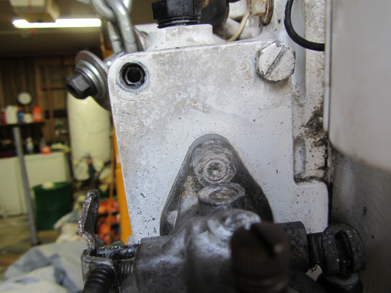

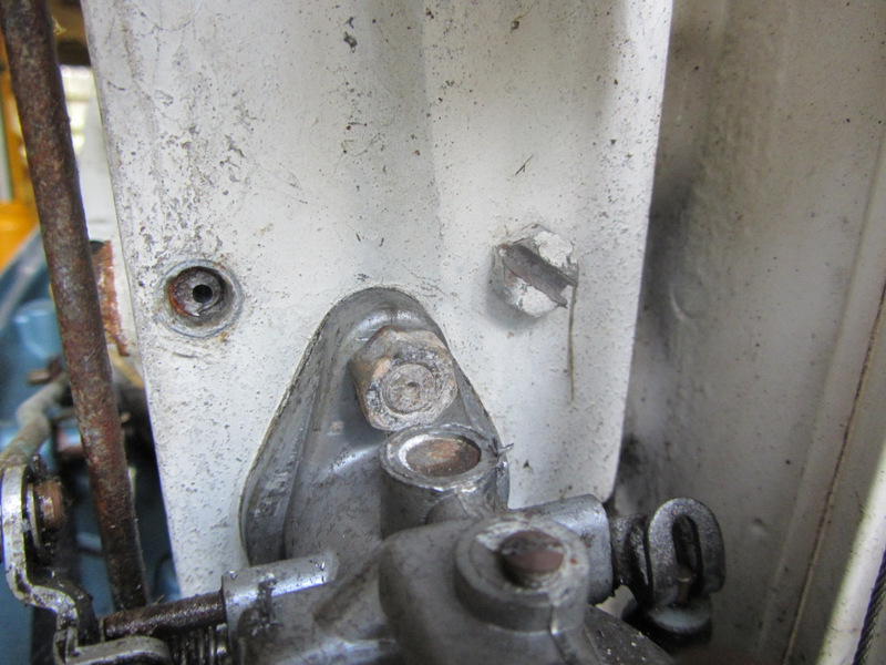

I need a little advice on how to solve this problem, two 1/4" bolts are snapped off on intake manifold and another one on the cooling manifold. I tried easy/out but that didn't work so now tapping 1/4-20 in center of 5/16 bolt. need to know how deep I can go using bottom tap how long are original bolts? and is this a through holes or does it have bottom in casting? i could go with Heli-coil but need more info . If I try to get out other bolts I'm sure there going to break I believe I'll have better luck if I let engine get running for awhile I'm not at that point yet, but close, maybe week out, but now on 10 hr. days at work so limited on time. Regards, Paul

For the remaining bolts - soak with WD40 for a while, then, without using too much force, try to rock the bolts back and forth (loosen/tighten) until they move just a small fraction of a turn. Continue until the WD40 gets worked deep into the threads. Once they break free, you will be able to turn them further and further. Don't try to remove them all at once as they will bind again. Eventually, they will come out.Originally posted by frogpond View PostI need a little advice on how to solve this problem, two 1/4" bolts are snapped off on intake manifold and another one on the cooling manifold. I tried easy/out but that didn't work so now tapping 1/4-20 in center of 5/16 bolt. need to know how deep I can go using bottom tap how long are original bolts? and is this a through holes or does it have bottom in casting? . If I try to get out other bolts I'm sure there going to break I believe I'll have better luck if I let engine get running for awhile I'm not at that point yet but close maybe week out but now on 10 hr. days at work so limited on time. Regards, Paul
For the broken ones, once the flange is removed you can TIG weld a stud onto whatever is left sticking out. Then proceed as per above.
Paul I can answer the length question and blind or through hole question by the weekend when I have time to dig out some disassembled parts. I've had the manifold plate off for gasket replacement several yrs ago but don't remember much about it. I do know the thermostat bolts always break, those I've had to drill and heli-coil.Originally posted by frogpond View Postneed to know how deep I can go using bottom tap how long are original bolts? and is this a through holes or does it have bottom in casting? i could go with Heli-coil but need more info . If I try to get out other bolts I'm sure there going to break I believe I'll have better luck if I let engine get running for awhile I'm not at that point yet, but close, maybe week out, but now on 10 hr. days at work so limited on time. Regards, PaulDick Johnson

Torquing the frozen bolt back and forth works every time, even in the most stubborn cases. With each application of force, the bolt shaft flexes enough to break a small portion of the corroded section free, from the top, down. You just have to torque it back and forth, until you work through the entire corroded section. Then you will feel the bolt turn, ever so slightly. Continue torquing in both directions and adding WD40 until you can unscrew it completely. The aluminum threads will be in good enough shape to reuse. No need to bore out and install a thread insert.
You can weld onto the broken stud without damaging the aluminum block in the least, even if it is broken off flush with the mating surface. In that case you cut the head off a spare bolt and drill a hole through the center of it, slightly larger than the bolt shaft diameter. Place the donut over the broken stud and weld through the hole.Last edited by Skagit Hideaway; 08-05-2015, 07:48 PM.
Pulled a manifold today, thermo and manifold bolt holes are blind holes. The depth of the thermo bolt hole is 1/2", the manifold bolt itself that I took out is 3/4" in length. The depth of the threaded hole is .719", damn close to 3/4"Originally posted by Super Sportster View PostPaul I can answer the length question and blind or through hole question by the weekend when I have time to dig out some disassembled parts. I've had the manifold plate off for gasket replacement several yrs ago but don't remember much about it. I do know the thermostat bolts always break, those I've had to drill and heli-coil.Dick Johnson
