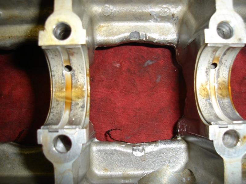

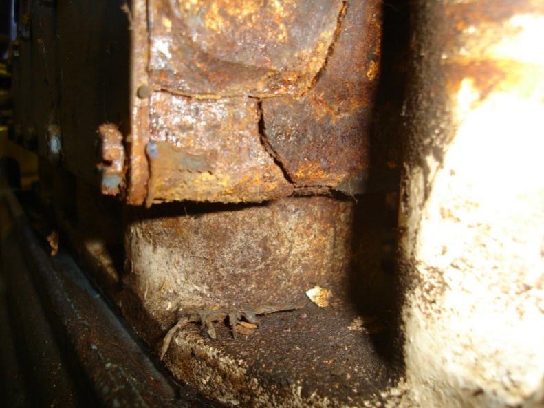

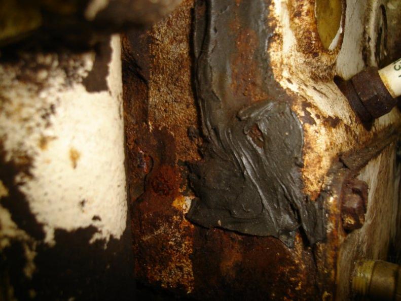

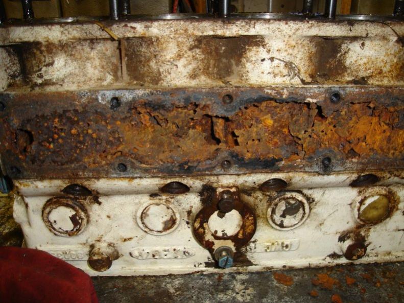

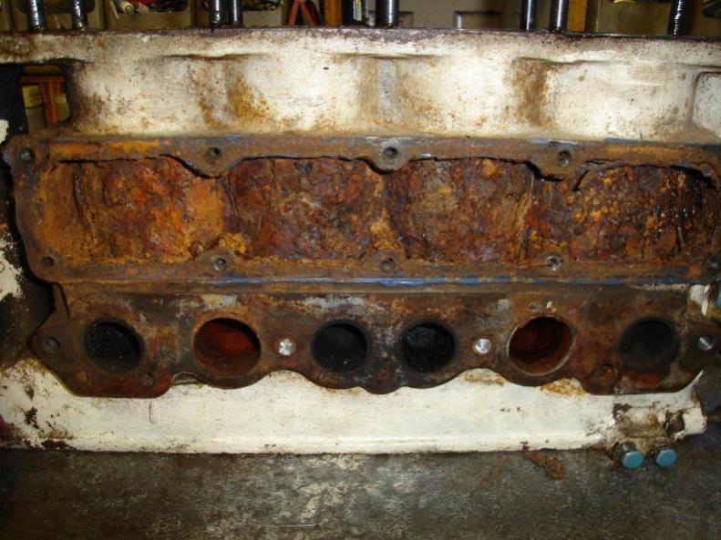

With the long weekend I decided to teardown the first Bearcat I bought. This one was stuck when I bought it, I freed it up and proceeded to start it up. Two cylinders had low compression, I was assuming the rings were stuck and running it I might get lucky enough to free them and bring up the compression. Finally getting it to start, the telltale was weak and after maybe 10hrs running time there was no difference in compression, it would have to come apart. It was full of surprises. Cracked block, and it looks like it may have lost a rod at some point in it's life. This probably explains why the "F" block had been replaced with an early Homelite block. With all the corrosion in the water jackets I can see why it did not leak water from the cracked block and why the telltale was weak. I had found a really nice "A" block to replace the cracked block. Teardown is complete and reassembly has begun. I've torn done a few lower units for repair, a nice simple unit, easy to work on and the powerhead also seems easy also to work on.

Man, I sure know you have to drain mine anyway.
Makes me wonder if I need to pump her full of antifreeze now too.
Mine Is the F block.Helmar Joe Johanesen
Winterizing
That's the second cracked block I've had, don't you also have one there? I'm thinking I'll pump antifreeze in all mine just for piece of mind. That drain is just a little higher than the bottom of the jacket and both of these blocks were broke in that area. My other "F" block that came from Lapine also had freeze damage, fortunately it only distorted the jacket cover and leaked at the gasket.Dick Johnson

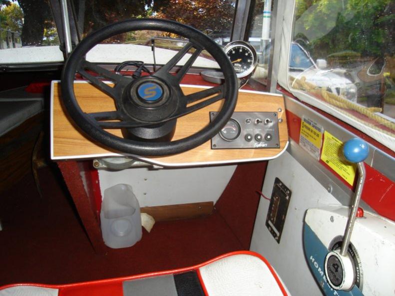

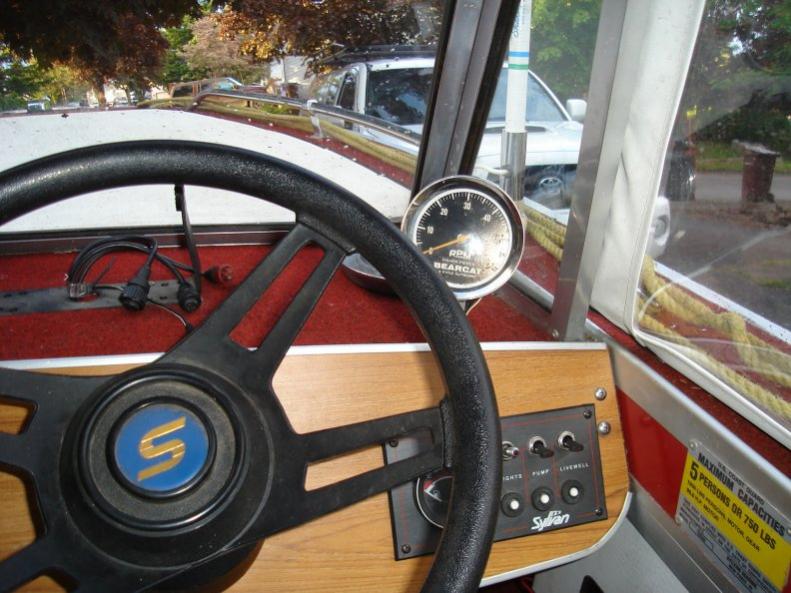

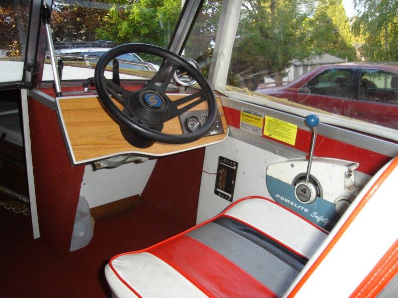

I've finished up replacing the stbd wood on the dashboard of the Sylvan, did the portside 20yrs ago, now they match again. I decided not to put the ignition switch and hot/oil light back into the dash as before. I recently won an ebay auction for an early control box and decided to replace the late controls with the early. The whole setup seems to work out better! The swivel seat misses the unit completely when turned 360 degrees. I'll finish the wiring today, still have the OEM tach to mount and wire, then light it off for the first time this year. If all goes well we'll be fishing Friday!Dick Johnson

Finished up the loose ends, everything seems to work. I did find my oil sending unit was no good as the oil/hot light would not light up with the key on. Changed it out and everything is good, tach is mounted and works fine. Fired off the engine Monday and it runs great, idles at 500 rpm. So it's hitched to the truck and ready for the morning.Dick Johnson
