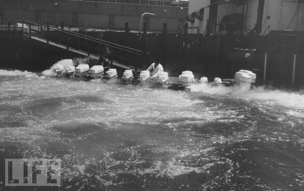

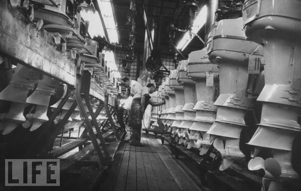

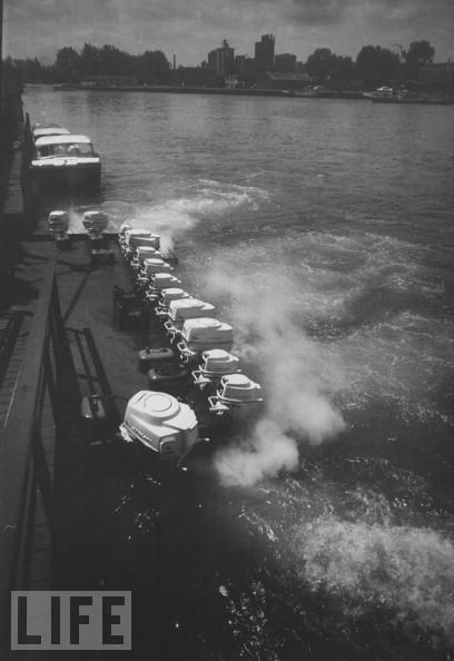

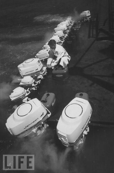

                  Here are some photos of how they did it at the Johnson factory circa 1959:

                      Mattson's advice may be better, but my outboard pictures were cooler...
                        those pictures are great!
