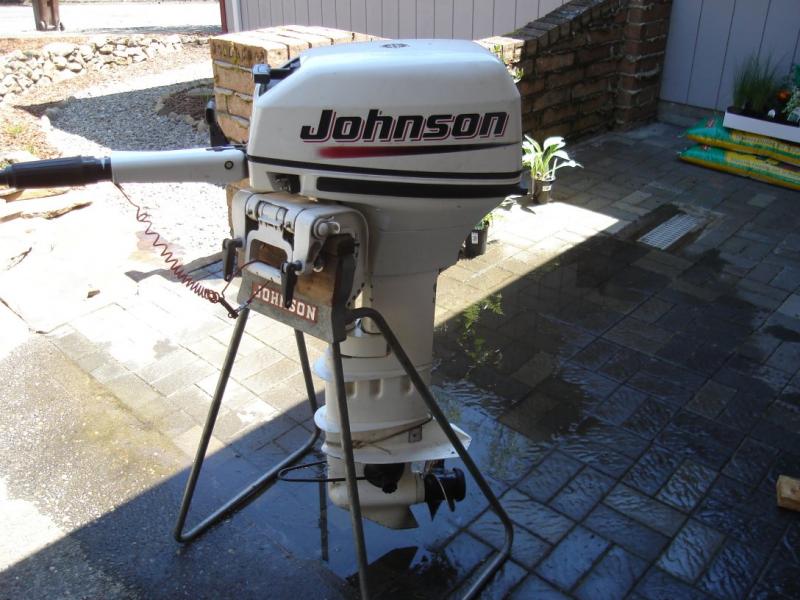

    I bought this a while back from a coworker, he said it wouldn't idle. He had in the shop several times they said there was nothing wrong with it. When I got it, it wouldn't idle just like he said. Like all newer engines (this is an '04) the idle mixture screw was impossible to adjust, special screwdriver and set inside a cup so you couldn't grab it with a pair of pliers. Out came the hacksaw, away went the cup and the mixture screw now has a slot in it so the average guy can make the adjustments as needed. Yesterday it idled perfectly in a tank, in gear for two hrs. I think it's fixed!

    They do that to appease the "EPA gods".......They don`t want to change the emissions they say each motor produces.The smaller the hole the better the fuel economy.....until it won`t draw enough to idle.
    You don`t want to run these motors dry for storage,just until they first sputter.
    Other makes use a brass plug over the "Pilot screw" ,we get to drill and slide hammer those out when they won`t idle.
    Sure beats the $400 carb replacement too.
    TM
      I don't even want to get started about the EPA gods. Same thing with my later motorcycles, drill and pop the plugs to get to the mixture screws. $400 for a carb, hell this one had more plastic in it than metal. It's crazy isn't it.

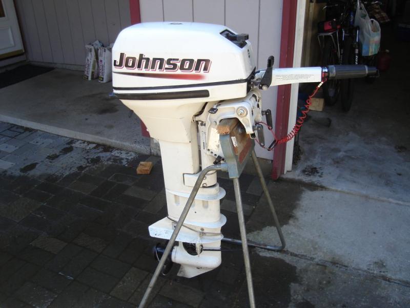

          This one was a 2 stroke. I think I've found another one, same engine just a few years older. Might be a road trip tomorrow!

            Little Johnson.
            That is a nice little motor.
            My youngest son has one of those on his little fishing boat up at Prinville Oregon.
            He has never replaced the pump impeller in it and I told him its time Before he has an issue. Use anti-seize too.
              2 stroke.....oops.
              Water pumps on those can be a mental challenge.
              You guys will love finding that shift rod release......hidden behind the water intake screen will be a 2 brass nut/ clamp and small little plastic ring that slips around the shaft,AFTER you get the nut out of the way ,you`ll see it.
              The shaft slips thru the water pump on re-assembly.
              Still nice motors,the front shifter is cool except for all the plastic.
