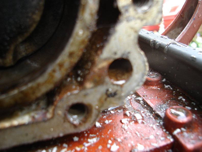

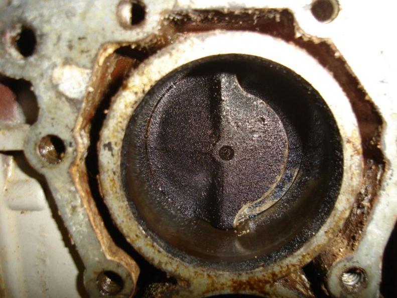

    I've done the powerhead swap, a CD20 is replacing a CD15. I've swapped out the head and intake manifold. Problem is the thermostat. I now have an exposed hole in the block. If I tap the hole for a pipe plug and plug it off will I still have cooling circulation like the CD15 would have?

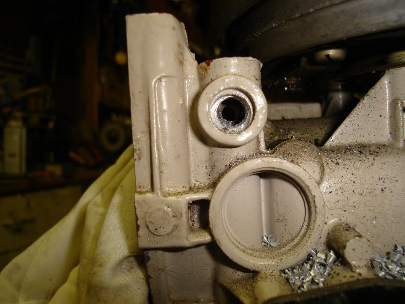

    The answer to my question is no but I found the fix. Upon further investigation the water inlet between the two blocks are the same. The discharge is different because of the thermostat so it actually is an easy fix. I drilled the passage that wasn't drilled in the late block as it is in the early block. So now I just need to plug the hole in the side of the late block like the early block is and plug the the thermostat hole. Water will flow now from the top of the block on the port side and discharge at the top of the block on the stbd side, just as the early block does.

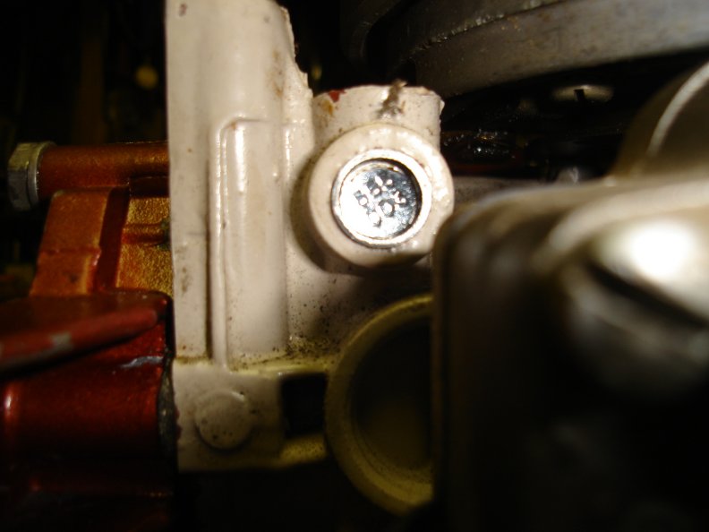

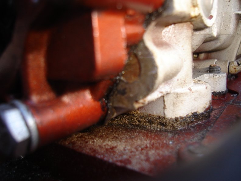

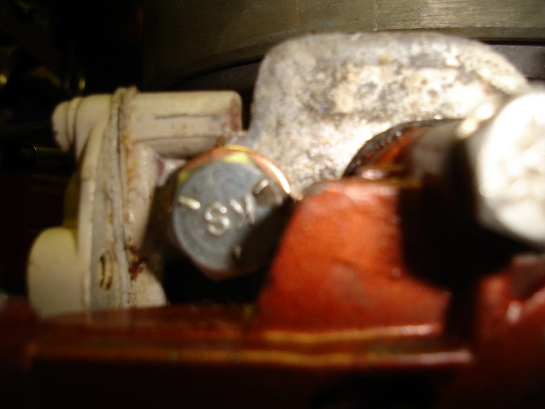

      I've installed a 7/16" soft plug into the block where I've drilled out the passage then tapped the open thermostat and threaded in a bolt with a copper sealing washer. I'll fire it off soon and see what happens!

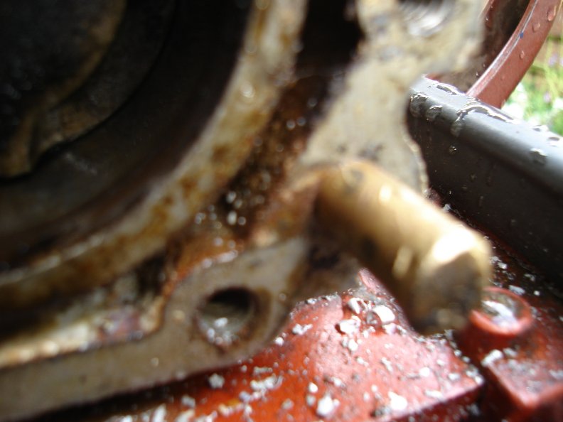

        Well I fired it off and discovered another hole that needed plugged. Cut a piece of brass round stock and plugged it. Fired it off again and it works!
        I've had it idling for a couple hrs so I think cooling conversion is completed.

                  I didn't ask why, I looked at the block and said why not. It's basically the same block with a material added for the thermostat. Comparing the two blocks and tracing the cooling flow revealed the undrilled passage in the late block. It then became easy. Just needed a steady hand and a watchful eye on the drill as there wasn't much room for a mistake hitting the water jacket!
