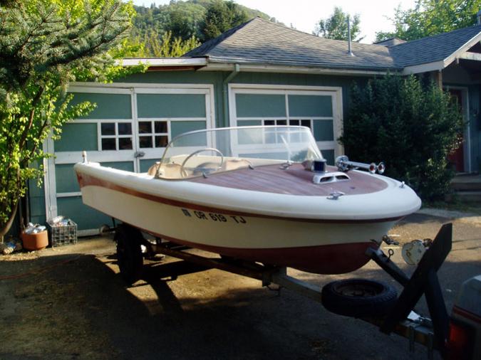

Hello all! New to this forum & really enjoy it so far.I have been slowly (very slowly) restoring a1961 Bowman 14' runabout. It's been a learn-as-I-go project that is currently in the floor replacment stage. Had not even thought about power yet but recently came across a late fifties-early sixties Evinrude Lark II 35hp. Starts & runs (a little rough) and is in decent shape for 75$. Don't know much about outboards but want to learn by doing. Is this motor a good choice for this and to power the boat? Any thoughts on this & the Lark II in general would be welcome. Thanks ,Mark

Looks pretty sweet
Hi mark, welcome to the forum. Nice looking boat. I'm not familiar specifically with the Lark ll but I have a 1980 35 LS Evinrude that I ran on my 16' express cruiser and it did fine. Got 23-24 mph wide open with two people plus gear, so you should do considerally better with a 14' runabout if the 35 is running well. Heh, for $75 bucks you can't go wrong, right. I paid $800 for mine. Does it have controls and electric start? I've always found Evinrudes to be great starters and dependable. My boat came with a 1958 35 LS evinrude and it runs great to this day. It just wasn't enough power for my boat (and it didn't have electric start) so I went with a 50. A 35 or 40hp would be perfect for your boat in my opinion.Kent & Diane

Fins - The scoop is my favorite feature ! I think I've seen a similar one somewhere before but can't remember where. Maybe on a car?
The boat was produced in Little Rock Ark. & so far I have not seen another one like it.

When I first saw the boat I thought the scoop might be an add-on but after a closer look am sure it's original. There are openings in it so air can get under the fore deck but I think it's mostly just for looks.
