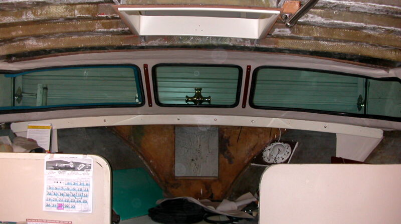

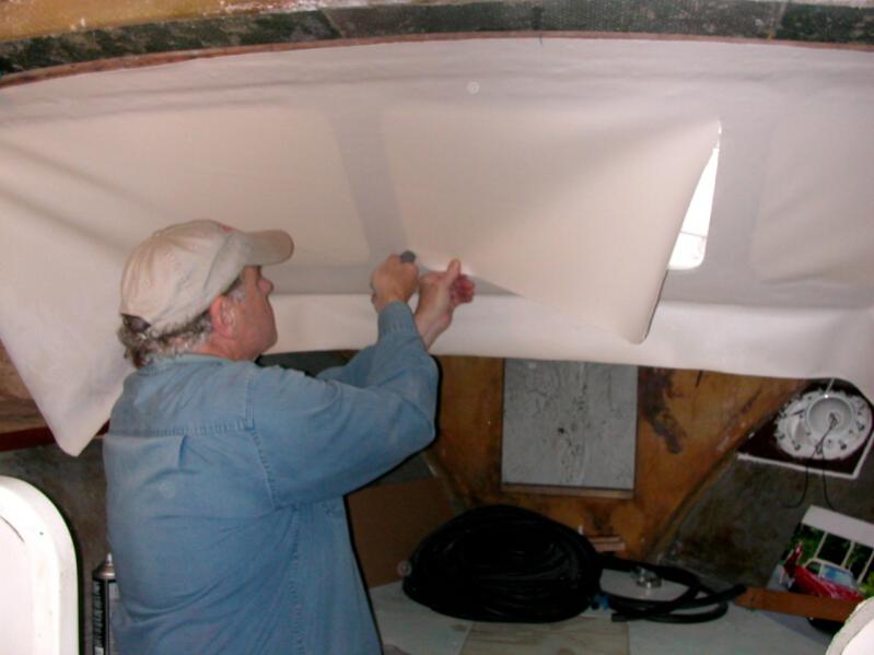

    My daughter Zoanna came up to Friday Harbor saturday to give me a hand with the interior. We spent the day installing the vinyl around the windows. Now that the vinyl is in the wrap-around windows can be installed. Put this off to the last..!

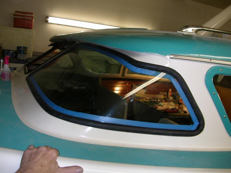

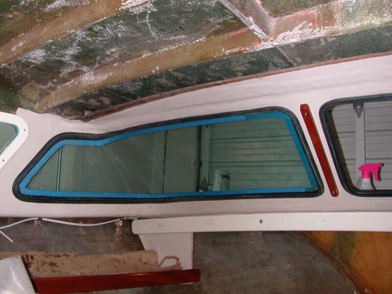

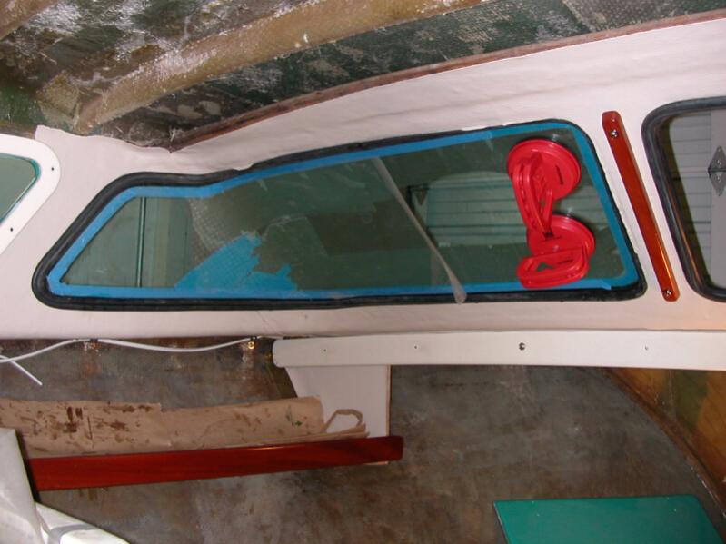

                      Check this out!
                      Well, I've left the curved glass in the front of the cabin until last...DUMB!
                      I hired a glass company a couple months back to install the center flat glass in the bridge. It was painful to watch...the guy pounding on the bridge frame. Broke the first glass and scratched the frame, but got the glass installed.
                      I learned something from watching him. I decided to purchase a vacuum cup or two to make handling the glass easier. Looked at many on line similar to the one the glass guy used. They were expensive...$60 to $120!
                      Last week I found an inexpensive one in the new Rockler Woodworking catalog. $7.19 each. I bought two. Vacuum cups are amazing. Says in catalog they will hold 100 pounds. I belive it. I really yanked hard on them...!!
                      Tried them out last night along with the other important glass tool, a cotter pin extractor. I dulled the point on the extractor and then ground a ball end on it then polished the ball.
                      Happy to report that I got the port curved glass in in under two hours. Surprised even me! Nothing like the right tools!
                      Hope the starboard one goes as easy! Pics attached.

                          Slick-um
                          Tim, that is quite a hunk of glass! You probably know this, but a little dish washing liquid on the rubber and glass helps to slip the glass in the channel. Keep up the good work, you are almost there. Way to go! - Ross
                          Ross Henson
                            Installing glass
                            Ross,
                            Yes, I used 50% dishwashing detergent and water. All this cabin glass is plexi. I polished the edges which I think helps a lot. The laminated auto glass was a lot tougher to install.
                            Thanks for the tip....
                              All glass in the Saratogan
                              Installed the starboard curved glass in the cabin front today. Took three hours. Center flat section took about an hour. Still have to run a bead of sealer around the glass and install the lock strip.
