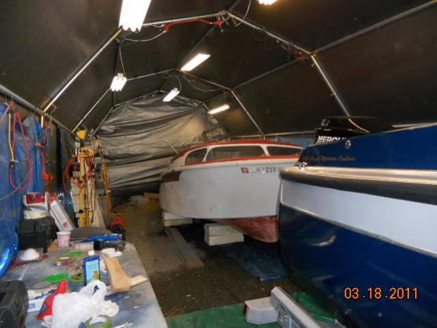

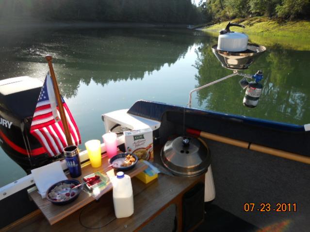

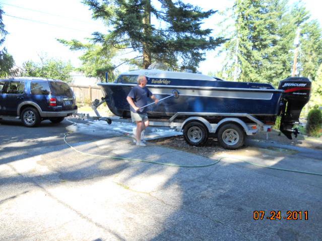

Joe, "O" yea ! I don't want to disappoint you, but i still do have " itchy" 17' Skagit sitting behind Bainbridge. Maybe i will sale it or i just might store it for a year or so as i still have some odds & ends i want to do with Bainbridge. Bainbridge sure ran nice on that smooth water this last weekend. We went just over 100nm. I dug out all of my old boat stuff from my Bayliner days like the dishes,hair dryer,vac, BBQ equipment etc. I have my old socks storage bags from other boats to snap to the walls inside the cabin to store items. The BBQ equipment made it nice to cook Dan and my burgers Sat night and the coffee ( I rough it with instant coffee ) on Sunday early am. I have not used the BBQ since about 1998. I even used my plug in hair dryer after that hot park shower. WoW ! what a weekend ! Before putting her away, i gave her a bubble bath and wipe down as she always like's that.....i think. Chuck1957 17' Skagit Express Cruiser

Pretty cool on the BBQ rig too. Always wanted one of them but never stepped up to the plate and got one.

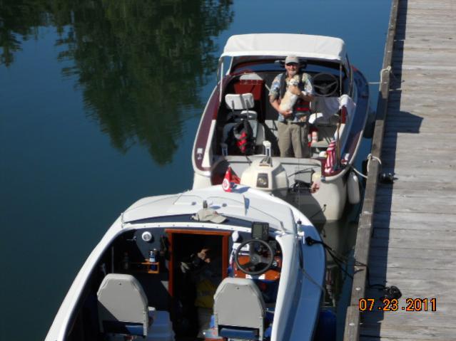

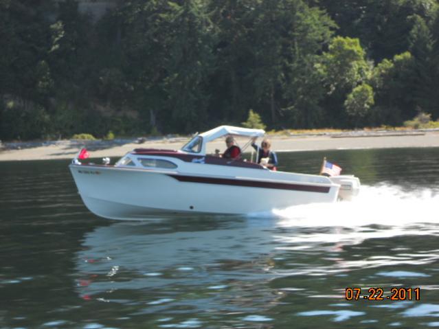

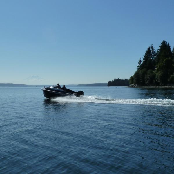

Joe, Few more pictures from Sat taken by Bruce Bidwell and some pictures of his boat. Chuck1957 17' Skagit Express Cruiser
