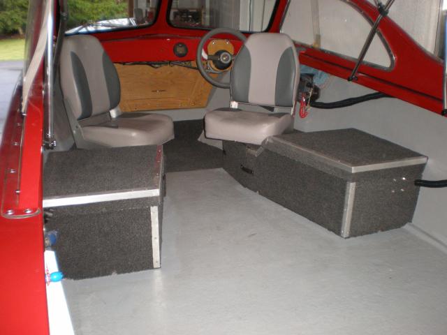

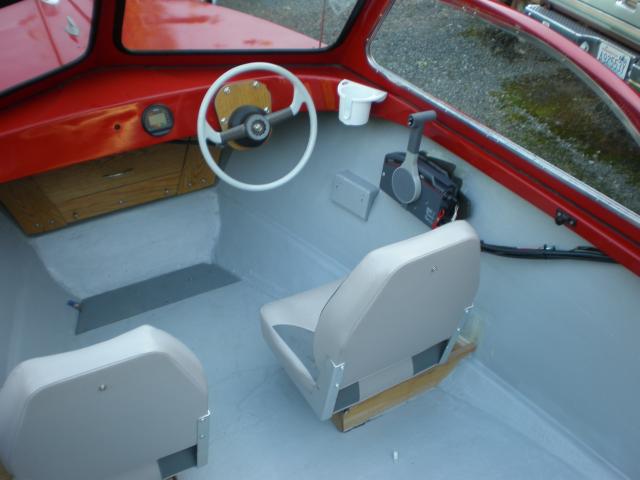

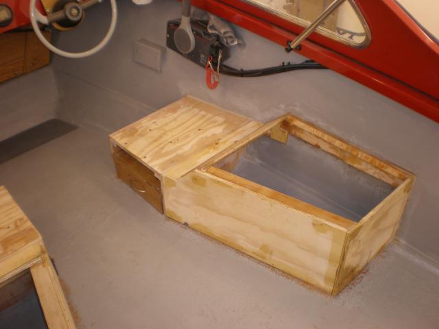

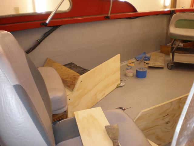

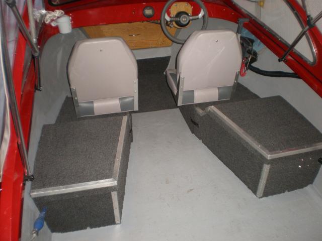

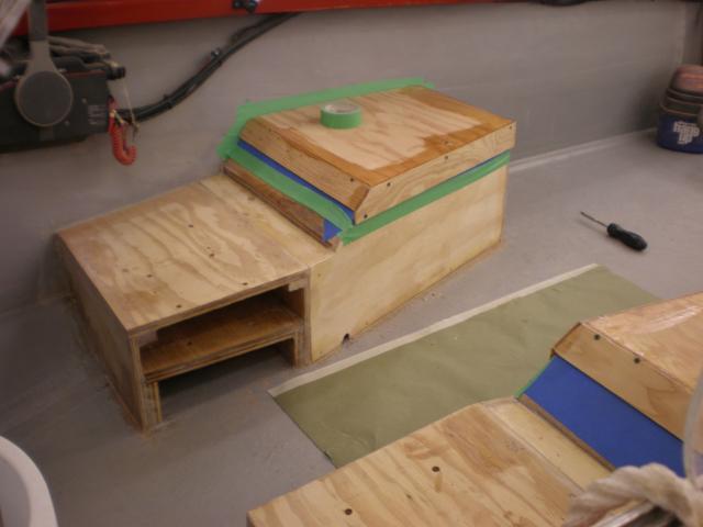

    Its been so long since I've posted, thought maybe I'd reintroduce my boat! She's a 57 BellBoy that I bought in 04 as a black berry special. After doing the usual rebuild, transom,deck,paint and such, I powerd with a 1956 30 hp Johnson pull start with cable steering. Shortly thereafter I repowerd with a sweet running Homlite and updated to a rack and single cable steering as well. We ran it like that intill last fall when I put on a 60 hp Yamaha Long shaft with tilt and trim. I had been wanting to move the fuel tank and battery forward and out of the splashwell (for the Bat) and raise the seats up some. I had origanaly built the seat mounts low as I had a hardtop on it for a time, but that proved to feel a little cramped to me. So I added to the old seat mt. and sorta just started cutting and fitting to come up with my current arangment. I think it will work out pretty good, Still need to do some venting and odds and end to finish up but ended up with my 6 gal tank on one side and the starting bat on a switch with room for another bat on the otherside. The carpet under foot is only on a try on but I might try to do some type of snap in thing with it as I like to swab it out from time to time and not sure the carpet on the floor will work out. Sort of a long rambling story... maybe I'll have more coffee! Hope to see ya on the water! - Ross

            Nice work Ross, your Bell Boy is looking great. Went the same way with motors myself. My Westerner came with the original 58' Evinrude pull start that ran great, however I replaced it with an electric start 35 Rude, then the Honda 50. Best thing I ever did.
            Thanks for the photos, always interestig to see club members winter projects.

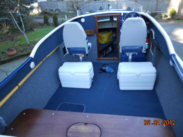

              Hey Ross Nice to hear from you. Those seats/tanks combo sure do look nice! If you are using Home Depot / Lowe's "indoor /outdoor" carpet, it will last forever. The Rosario still has the same carpet in it ( unless Jerry changed it ) since 2003 and my Skagit has it as well for the last two years.See that vacuum ? U need to get one of those to keep your carpet spiffy. Nothing like a vacuum when out on the high Sea's. LoL ! What i did on the carpet as far as having snaps, i screw down the carpet across by the bulkhead with a nice looking washer and then add a colorkeyed snap like a person uses on their canvas.It makes it look like it is just snaped down. Being i don't fish i have no need to be taking it up to wash it only vacuuming it. If it gets water on it i roll it back and let it dry out or use a shop vac. Only happen one time at Lake Whatcom back in about 2005 in a all night rainstorm. Best,Chuck
                Not only does Rosario still have her carpet but we installed the "whole vessel" vacuum system and a generator to power it. Gotta do that carpet regularly as Becky and our dog Joy sometimes track sand on board! Next improvement is the heated port-a-potty seat!
                  I found some cool vent covers at the hardware store, they are for the soffets under the eaves on a house. Worked good just made a 2" hole with a holesaw and they fit right in. I guess that should be enough for a vent I put 3 on each side. Also fabbed up some nylon straps with snaps to keep the covers/seats from blowing off going down the road. Gotta fix a burnd out light on the trailer and I'm ready... Oh wait someone said there is a football game on tommorow I need to watch. Maybe next weekend.
