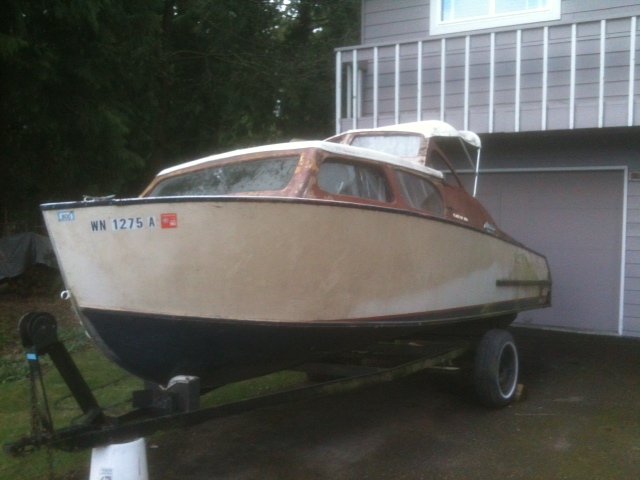

    Hey all moving up to Orcas Island and I'd like to give this runabout away...comes with trailer...needs lots of work but is a NW classic.... Trying this verses taking her to the dump...

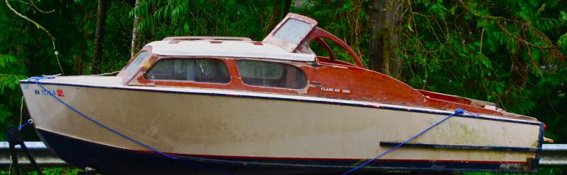

            Just fyi, here's a photo of Bud McChesney, the builder, testing one of the 18s, probably in abut 1952. The boat pictured is a bit different than SahSen's--maybe just a bit older--but it's the same basic model.

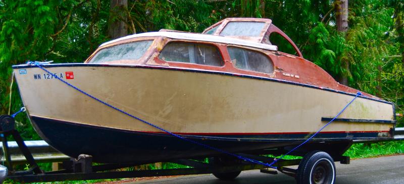

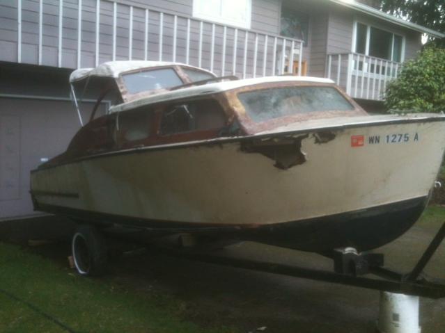

              Well, the '56 McChesney is a beautiful design, at least to my eye, but you have to squint a certain way to avoid staring at the extensive rot.
              This will be a big project, and I haven't even gone at it yet with an ice pick, but for starters the 'Harboard' ply used to build the hull has rotted completely through along the starboard sheerline; in lower corners of both side panels just forward of the transom; in the bottom aft near the transom, and most everywhere in the transom itself, including the transom framing, chine ends and who knows where else. The mahogany cabinsides are weathered but not bad, but the cabin's forward window-frame panel is rotted in the corners, so it's easy to imagine that the entire cabin (sides and front, at least) will need to be surgically replaced. The cabintop beams seem to be in excellent condition, but the upper windshield frame will probably have to be replaced. And, oh yes, the entire foredeck and side decks will have to go, since there's rot in a few spots and the rest isn't worth saving.
              Other than that...well, gee, it'll be a snap to restore...(!)

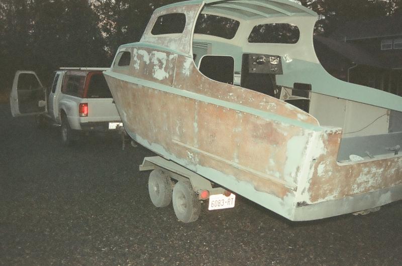

              Here are a few shots of the boat, taken this afternoon, along with a few brochure photos showing the McChesney 18 Vacationer model in the mid-1950s.

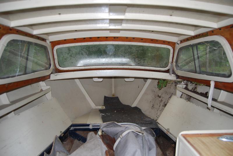

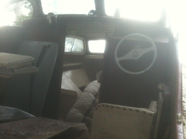

                          Overall, the boat is very close to overall length of an 18-foot Lady Clipper, but there appears to be a lot more room inside the cabin. And the cabin interior is totally intact...just a dirty mess right now, with the old canvas top and miscellaneous stuff tossed inside.
                          First step, which I might do before even dragging the boat over to the shop, will be to pull up all floors in the cockpit and cabin, so I can check condition of the chinelogs stem-to-stern. If they're okay, that'll be a big plus...but if they're shot from one end to the other, the boat might be a goner (since that would automatically mean you'd almost be building a new boat during the restoration--which is not a bad idea, come to think of it!)

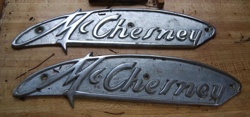

                          No promises right now, except that I won't sell it because if it's deemed unrestorable, nobody in their right mind would pay a dime for the thing, unless they really want the nice cast-aluminum McChesney emblems.
