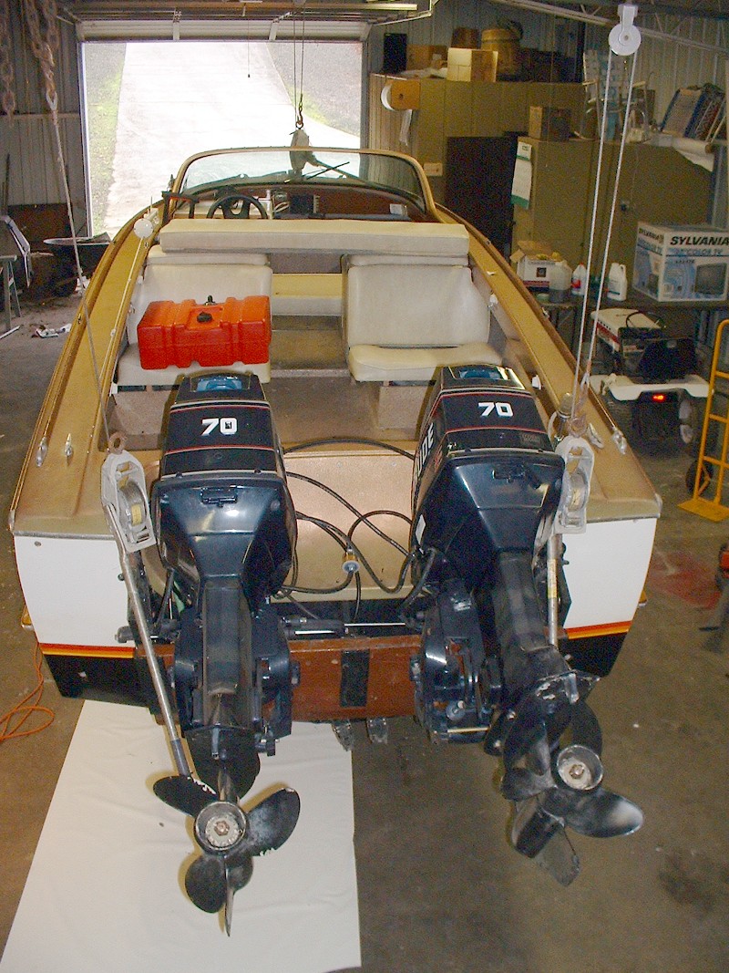

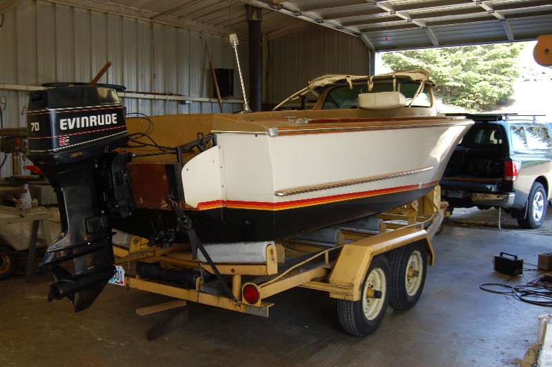

I had twin 90s on my 1956 Glasspar Mariner it ran great, My Father in law put as safety feature for ocean fishing. Top speed 38 mph. At that speed if you moved in the boat or it would start turning, definitely exceeding hull speed. I took one off and am very happy. 28 MHP at WOT. By the way, It is for sale.
Not sure why I didn't realize you were from Oregon.....Nice Shop !!!.Originally posted by 56glasspar View PostI had twin 90s on my 1956 Glasspar Mariner it ran great, My Father in law put as safety feature for ocean fishing. Top speed 38 mph. At that speed if you moved in the boat or it would start turning, definitely exceeding hull speed. I took one off and am very happy. 28 MHP at WOT. By the way, It is for sale.
I think that Glasspar's hull was designed a little better than most....
Nice engine, any trading for it
I need a engine for my Dorsett project, that would scoot her right along too....
