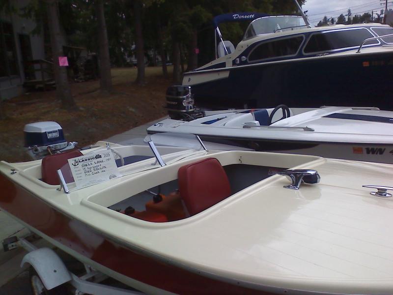

    So I recently purchased a "Shell Lake" 13ft runabout from Greg S. It was previously owned by Chuck. For all I know someone else may be familiar with this double cockpit little boat. It was at the La Conner show next to Chuck's Dorsett & Glaspar.
    It is a light little boat but it came with an Evinrude 50. As some might know this is a heavy and powerful motor. I believe this is the same setup Chuck had on Rosario and that pushed her over 30mph. The point being that the 50 might be a little much. It's a kick in the pants with at least one other adult in the front to level it out a little, but I bought the boat for my boys to run. So I've been thinking about other options.

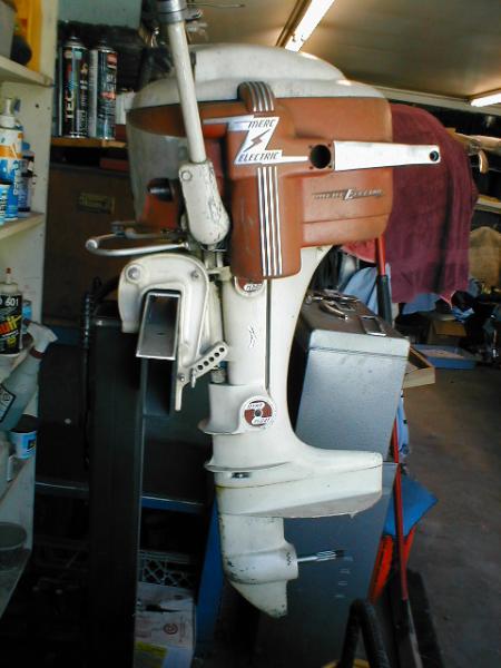

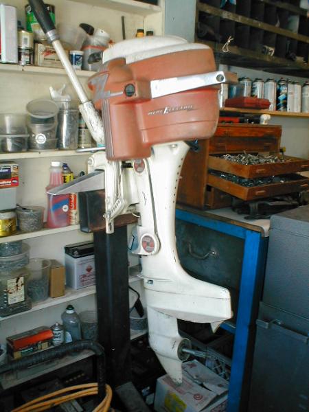

                Merc Elec. Start 25 hp.
                Medic One, I have a short shaft Merc. Mark 25 Electric start with controls & Merc gas tank. $900 installed, running & guaranteed to be a great little motor.
                Lon

                    Thanks for the offer on a sweet looking motor. I have to say that would be aesthetically superior. However, my budget is already blown after acquiring two boats unexpectantly this summer. I think $900 might land me sleeping out in the boat with my wife locked comfortably in the house. Additionally, reliability, parts availability and ease of maintenance is very important also. Thanks again -Zachary
