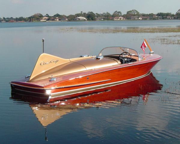

    Chris-Craft Kit
    Tom -
    As you know, Chris-Craft produced a lot of boat kits in the 1950's, in the middle of the do-it-yourself boom of the period. The company also realized it needed to do more for folks who couldn't afford the expensive and larger Chris-Craft cruisers and mahogany runabouts, so the kits filled a real niche.
    Back East, a company is now offering perfect copies of some of the original Chris-Craft kit-boat designs...but they haven't yet gotten into the small cruisers like yours--just the plywood runabouts, so far.
