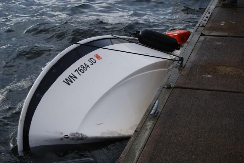

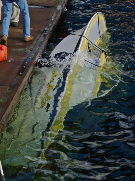

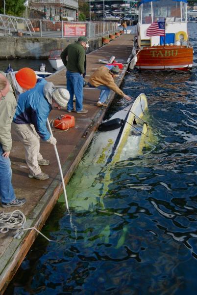

    Today's New Years Cruise was marred by the sinking of Tim Mattson's 17-foot Glasspar Seafair Sedan at the Ivar's dock. The boat went down when nobody was looking, while our group was having lunch inside the restaurant...so we don't know what caused what was obviously a sudden sinking...but the bottom line is that Tim is tonight facing a substantial bill from Vessel Assist and maybe other parties.
    Some of us had an informal passing-of-the-hat at the scene, but as of 4 p.m. the Vessel Assist boat had been unable to raise the sunken Glasspar, and their billing clock was running. A diver arrived shortly after 6 p.m. and just before 7 p.m. the crew got the first air bag into the boat and inflated, bringing the bow back to the surface. Tim reported that they hoped to get a second air bag into the stern area and bring the hull level with the surface so that high-volume pumps could begin to float the boat.
    When the boat rolled over, it was still tied to the Ivar's float by bow and stern lines, but it quickly became obvious that there was no way to roll it upright. (It was sobering to realize how unbelievably heavy one of our boats can become when submerged. Gordon Davies, with crew help from John Nelson, attempted to tow the sunken hull toward a nearby beach, but Gordon's big Merc was unable to budge the sunken boat; it just sat there on the bottom, as though firmly anchored in place. At that point the bow line was returned to Ivar's float, where it was secured to a dock cleat.)

    I`ll fill in some details but all drain plugs were in,BUT the splashwell one should have been out.
    Bilge pumps were working well as we got it floating and were bailing away as they should.
    Boat sunk motor down in the muck ,any deeper and it would be gone.
    Took 3 air bags to get it up,then a 4`` Water cannon drained it in 5 minutes.
    Kicker survived,and even got the fishfinder/Gps back.

                My Diver couldn`t leave Fisheries Supply but had the 3 air bags on and the boat up in an hour,then the big pumps came out and a 5 `` stream of water was flowing the good way.The lake was lapping into the boat and seeing a diver in full gear INSIDE the cockpit was ,well a little bit amusing.
                Had to try and make light of it,people were very polite (and let me run back and forth like a head-less Chicken).
                We never should have untied the hull from the dock as they could have winched it up almost level if the 2 points we had were still short.
                Jay called it, "it will sink as soon as we let go".
                Should have listened but the shore was oh so close.
                My Auto-Bilge was pumping as it came up, bye the way! The 5`` pump barely kept up with the wind-driven waves.
                Bottom line was Bad parking,had the splashwell facing the waves,once full it wasn`t too long after I`m sure.
