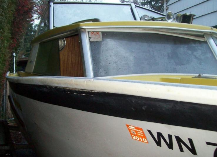

          Pics and more stuff

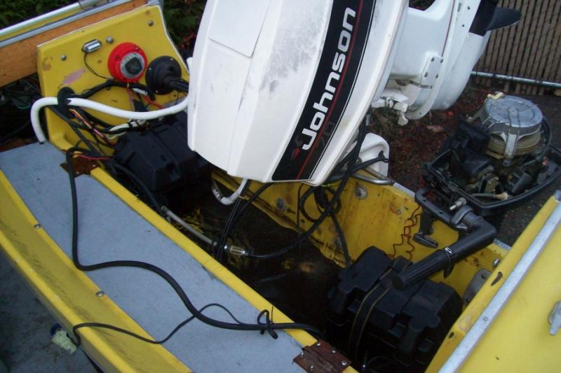

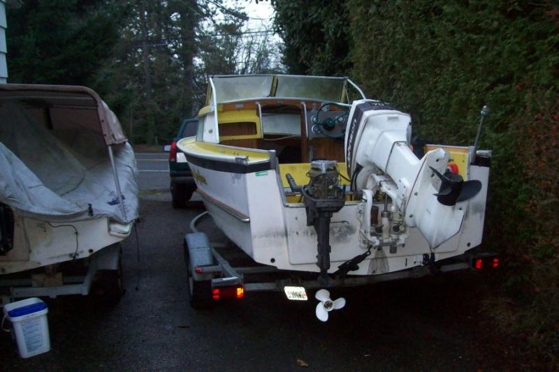

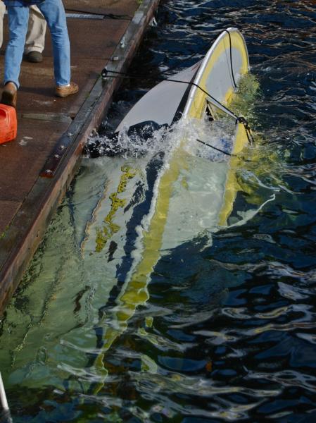

          A couple bits of info.
          My rear dock line was actually going to the outside cleat and hooked with a caribiner just by chance.
          My fender took up the dockside cleat and know I also see why Chuck C` boats are near and tidy,homes for cleats and homes for fenders.
          As Marty said ince th ewater caught the hull,it was stbd down with my bottom fom I did do DO the outer 2/3rds on almost all my rides,just not the middle.I tried to "supplement"not float the whole boat or change things too much.Figured I`d always be there.
          I`ll be slipping foam in the gunnels for sure ,but it will be pinned in place well.SAFE boats acronnym starts with the word "Secure".They used 3/4 `` SS bolts into 1/4 channel.
          My 1/2 empty fuel tanks blew my rear cross bench apart,screw from above were good for standing on but not for holding the hull up.
          I only lost the Black nylon strap I used to pin the fuel tank to the one side.The quick pin latch snapped clean so the fuel line never opened to the water.Quick release so to speak.
          Final note(scratch that...),Wave cycle time was under a half second on this skinny lake with the wind funneling from Vashon/ Blake ,along Alki and thru the Seattle Center where it venturis right at Lake Union from the SW.
          The end we where at was the last funnel with water flowing west.
          Sidenote: The salvage/scrap Glasspar I bought a motor from recently was snickering at me as I walked down the Lake Union Boatyard to re-organize Jeff Pullen`s Shamrock.
          Note the Boat never actually touched the bottom as the Mighty Johnson held the Load.
          Black Soot in pics is from the Diesil we had to use to run spotlights ,hmmmm,since Fisheries Supply in Seattle ( Hey Barry!) wouldn`t let my Buddy leave work to help his friend 3 blocks away.He has his side to....
          I should have called or walked over and pointed out air bags and Manifolds were ready to rock.Seems the story got out after all the people who quoted huge sums to come get wet checked back on a workless Monday to see if they could now do it cheaper.
          "Oh ,he was done in an hour and a half?" kinda stung but let BJ make a name for himself on the Lake.
          Now the one guy I should have called from Elliott bay is courting BJ to be his number one diver making real money(and getting some timeoff in summer to play instead ,"wait until decmber/Jan."...which is now ,hmmm again).
          Easy to 2 nd guess now,but it was pretty much my own Folly with bad parking huge.
          We also really couldn`t have defied that current which I know from working from from boats up against boats all summer all around this same shoreline.The current flows to the Locks constant,any wind the opposite or even tangent too will get you twisting even when floating dry.
          I`ll pt some more later,tried to read all the comments while uploading the pics I know you`ll want to see.
          Looks like window and rubrail time.
          The g3 has a Voodoo doll I can`t see somewhere.I keeping going by with first restos now it`s ready and maybe passed by for the last time.....5 years of getting skipped would piss you off too,I guess.

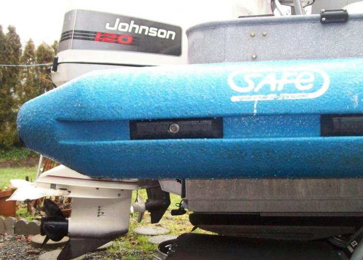

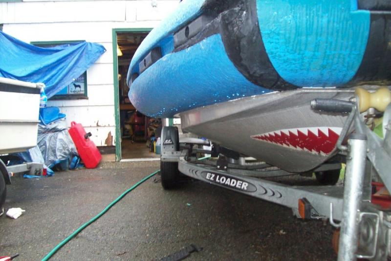

                        Here`s what I usually use on bad weather days...now 18 years old!
                        This Boat comes with a PFD,Rhino -lined Closed cell collar,tough enough to cartwheel your Cyclone Gate and survive.Don`t ask,wind happens.

                            Ideally, I'd love to have Tim's Safe Boat epoxy coated foam belt around my hull, as ugly as that might be. Fishing Admiralty inlet leads to some hairy water conditions. my $000.02 ChuckB

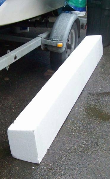

                              Got some Foam ,just temporary so I can go watertest and feel prepared.
                              Splashwell mods to come....I think it`s more like 60-80 gallons,but even 40 is 320 lbs!
                              Note the foam has an angle on one side so it can go against the outer hull.Should run around $25.00 per block,this is a test pc before I pour or make a cover of some sort.
                              White won`t be good under the deck as Gas will melt it,plus it shreds if not bagged ,which I`ll do with Hefty "Steel Saks".I will clone whatever fits in pourable foam later on.
