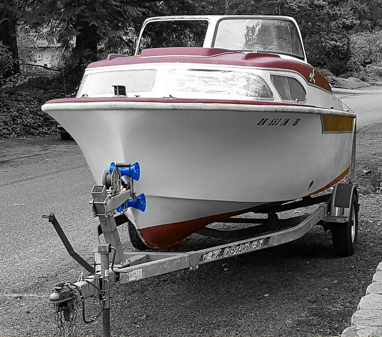

    This picture reminded me of Chuck Carey. I know he would be posting for me to just put a custom windshield on this one
    Leave a comment:
  • Kelly
    replied
    Thanks Bruce. Pictures hide a lot
    I spoke with Keltech plasitcs in Tacoma as they specialize in...plastics! They recommended acrylic over lexan for durability however cautioned that both will scratch easier than glass. Maybe I can make a "bra" for the windows when towing the boat? hmm...
    I did ask for a quote for both materials and will make a decision based on that.
    Here's the frame and today's small cleaning progress:
    Still more work to do. Structurally the frame seems strong, there are several cracks in the gelcoat and a couple of holes to fill. The real prep is the window sills so I can get a good fit on the windows.
