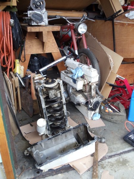

Hell of a design from the early 1940's! The 85hp Bearcat had only 3 main bearings. I always thought is
was too bad they didn't just add 2 more cylinders to the Crosley block and get it up to 85hp.
So I see a motorcycle in the background, Benelli? And the head above the Bearcat blocks looks real familiar, L series Datsun?Dick Johnson

Early 60's Ducati 90cc that belongs to my son and yes L24 head for my old Z car I've had for 40 years. Buy the way Ed Ewing is sending me the gaskets I need and provided some detailed instructions that I attempted to write down as we spoke. I will call him back when I really get into the work to make sure I get it right.
I found some pictures of the Crosley pan gasket on the Bearcat block. It works with some modification but the only one of the end cap gaskets is correct. I ended up using one of my old ones. If you get some 1/4" cork you can make one.Originally posted by Craig Aho, post: 29752, member: 2327I recieved the Gaskets and O-rings today from Ed Ewing, real fast shipping.Dick Johnson
