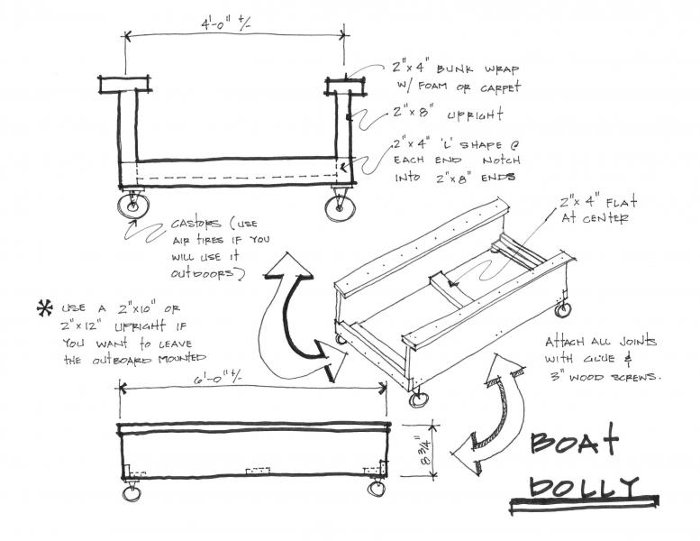

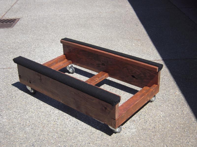

          I have built and used several of these rolling cradles for my boat projects. I have found that if you store the boat on a dolly, you can fit more of them in a covered hiding place! I adjust the size of the upright piece depending on motor or keel.
          We even built a small one for Cole's Skeeto. It is amazing how good cheap stain on a Home Depot utility stud can look!

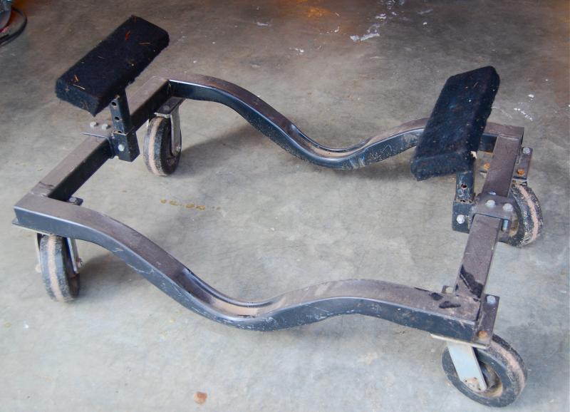

            The standard dollies we use are similar to the ones in the first photo below--heavily built of steel, with casters that'll take a lot of weight and adjustable-height padded bunks. You use two of these under a typical boat--one near the stern, one toward the bow. If you link two of the four-wheeled casters together with 8-foot-long padded 2x8 fir planks (bolting the 2x8 on in place of the little shorty pads), making them resemble the caster in the second photo (but with 8 wheels instead of 4), you can easily support most of our 20-foot and under boats.
            Brian's design is excellent for smaller boats.

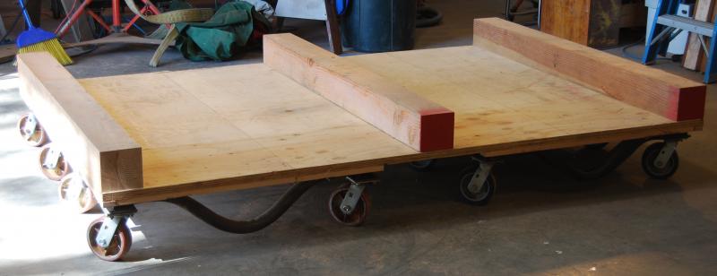

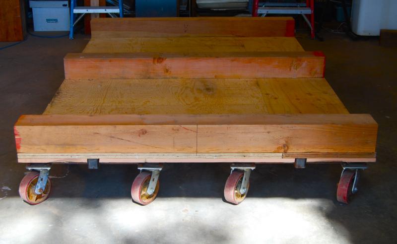

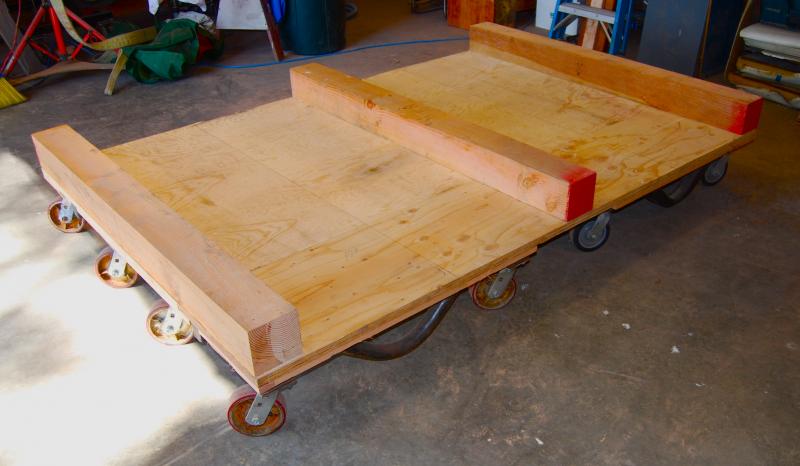

              This afternoon I removed a sailboat from the 16-caster boat cradle, making it easier to photograph. (See pictures below.)
              The 16-wheeler is made up of four of the steel four-wheelers, fastened in position under a 5-1/2' x 8' plywood deck, with fir 6 x 6's across the top. Typically, the keel of the boat is positioned on the centerline, resting on the three 6 x 6's (sometimes blocked up higher under the keel), with adjustable boat stands or 2 x 8 posts screwed into sides of the 6 x 6's to support the hull...with carpet scraps for padding.
              The last photo shows one of the typical four-caster boat stands used to make the 16-wheeler (obviously with the vertical support posts removed). Two of these smaller guys are great for moving most boats around--like 20-foot glass cruisers--but the Big Boy comes in handy with heavy, deep-keel sailboats or extra-hefty powerboats.
              I used plywood 'car decking,' the 1-1/8"-thick underlayment, for the deck of the 16-wheeler. The stuff is super-strong and doesn't tend to warp like some thinner plywoods.
